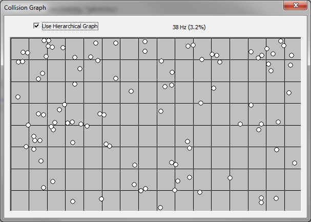

In the example, I generate 100 discs which bounce on each other inside the dialog window. A snapshot is given on Figure 1. The collision method is a simple square-distance law (the square of the distance between two candidates is tested against the square of the sum of their bounding radius - to avoid computing a square root). When a given disc is found in collision with another one, its speed is updated for the next frame.

Looking at Figure 1, it looks obvious that it is not necessary to test the entity in the top-left corner with the entities in the bottom-right corner as there is no chance that they could be colliding (they are too far away from each other). By looking at nearby entities only, we can reduce the number of tests to do. For example, if we have two equal sets of particles (each set being far away from the other), we have roughly 2(N/2)2=N2/2 computations to do instead of N2 ones. By having more sets we can reduce the number of computations even more.

I now consider that a better way is to rely on a specific BSP tree where the cut planes are restricted to the major XYZ axis. Each node is then divided in only two nodes according either to the X, Y or Z axis. To prevent the dimension issue, I use the plane that cuts the largest dimension axis. In the case of Figure 1, where the dialog is larger on the X axis than on the Y axis, I first cut the rectangle in the centre along the vertical axis. I then cut along the horizontal axis and so on. An example of three subdivisions is given on Figure 2.

The application was tested and yielded a maximum performance over the N2 reference of 3.2% (more than 30 times speed increase) for nodes of less than 32x32 pixels. The performance changed with the number of nodes but did not do better with more subdivisions. More nodes usually give better results (up to some point) but also require more RAM to be used. You should test various node sizes and see what behaves best for your application.
