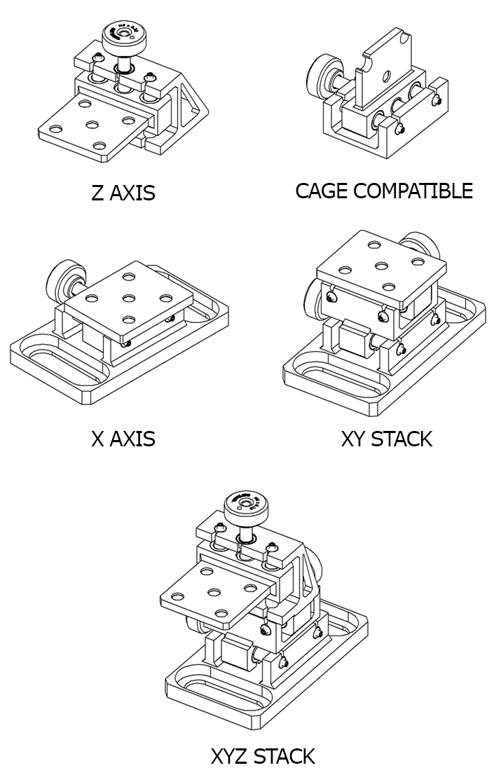

The various translation stages proposed in this post are shown in Figure 1 and can be downloaded here under an open-source CERN OHL V2 license for reproduction. The proposed family comprises X, XY, Z, XYZ and cage mountable translation stages. Holes in the carrier plates are designed to accept short M4 threaded inserts from CNC KITCHEN.
Figure 1 – Linear translation stages family

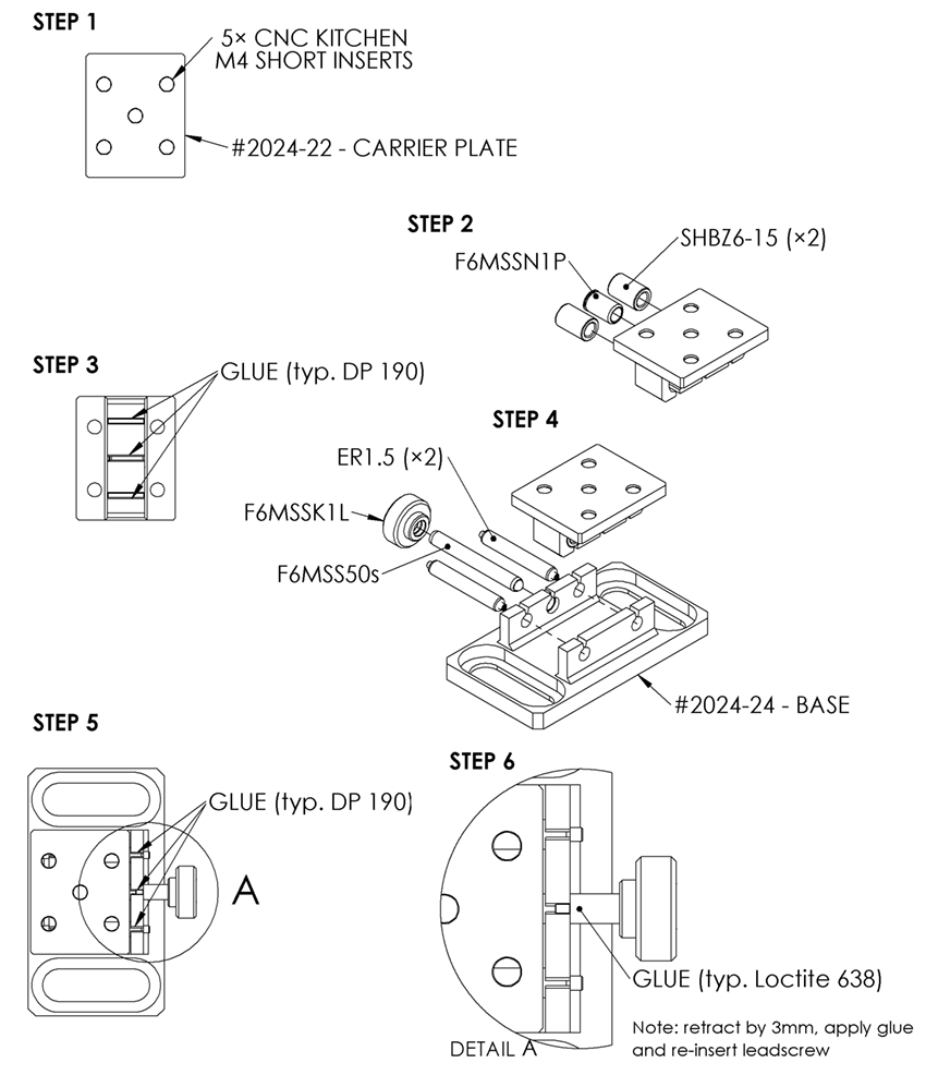

The assembly is broken down into multiple steps:
Step 1: add the threaded inserts. Technically you can do it later but if you screw up your work it’s easier to fix it from the beginning.
Step 2: add the bushing and leadscrew inserts. I systematically rework the holes with drill bits before inserting the parts.
Step 3: glue the bushing and leadscrew inserts. I recommend a thick epoxy glue like Scotchweld DP190 for this job. It is also important to have decreased all surfaces in contact using acetone first except on PLA where it’s preferable to use isopropanol.
Step 4: insert the rods and leadscrew as you place the carrier plate. I recommend assembling the screw button to the leadscrew first using some gentle torque to avoid it getting loose later.
Step 5: apply glue to the ball bearing and rods fixture groove. Again, I recommend a thick epoxy glue and to degrease all contacting surfaces first. Pay attention that you don’t pour acetone into the ball bearing itself!
Step 6: retract the leadscrew by about 3 mm and apply some thin glue, like Loctite 638. You will have to thoroughly decrease the leadscrew in the contacting area for the glue to adhere properly.

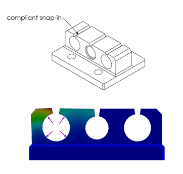

A relatively central aspect of all stages is the mounting mechanism used for both ER rods, bushings and threaded lead-screw inserts. Because of the relatively low precision of 3d printers (compared to professional CNC milling machines), it is difficult to design holes to capture the mechanical elements: the holes are either too tight or too loose. A convenient property of plastic printed parts however is that they deform moderately very easily. All holes are therefore designed as a compliant snap-in mechanism, as shown in Figure 3. The holes are designed slightly too tight at first but have some deformation capabilities such that you can press-fit by hand the various mechanical elements into place. Once in place, some epoxy glue can be poured into the groove to fix them once and for all.
Figure 3 – snap-in mechanism used in all stages

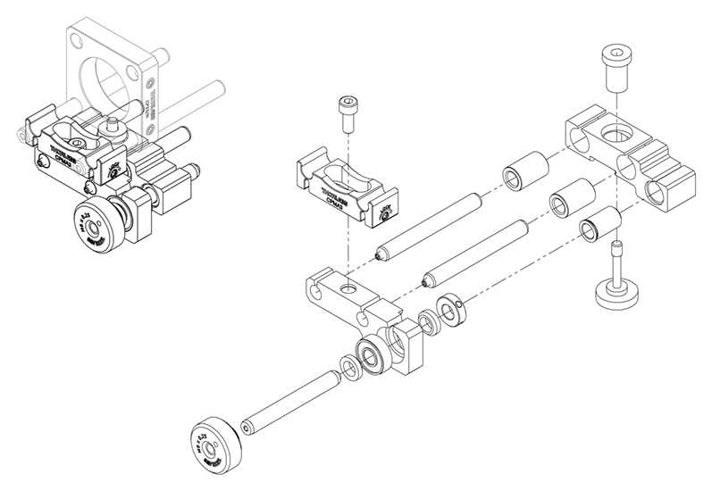

Last but not least, the stages shown in Figure 1 are by no means the only systems that can be built and should only be seen as examples of a more general concept. To illustrate this, I also designed the cage-system alignment tool of Figure 4. Its purpose is to be snapped on a cage system to be aligned and have a fine-pitch screw drive the adjustment of cage plates elements. Typical usages are, for instance, to set in focus a camera, pinhole etc. where fine motion is required. I haven’t seen such tool before at any of the common optical suppliers and can therefore be considered as an original concept. It can be downloaded as a prototype version here under an open-source CERN OHL V2 license as well for reproduction. Note the usage of the larger bearing this time with a nut-locking system, avoiding the issue of having to glue the leadscrew.
Figure 4 – Cage alignment tool based on the same concepts (prototype)
