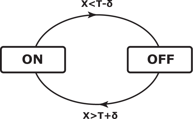

The basic FSM is relatively simple and only checks if the biomass is above or below a given threshold T in which case the pump is either turned on or off respectively. The FSM is represented on Figure 1. The threshold is slightly tuned by a small value δ for each case to create a hysteresis pattern and prevent the pump from being turned on and off constantly. During execution, the pump is turned off until the biomass reaches a level T+δ where the feeding pump is turned on. As feeding occurs, the culture medium is diluted and the biomass gradually lowers. The pump is stopped when the biomass reach the level T-δ where the cells are left growing on the new substrate added. The biomass should then settle around the threshold T with small oscillations due to the hysteresis pattern.
However, if the threshold is fixed above a critical value Topt (I will show that this critical value is also the optimal one), there will not be enough substrate added by the feeding to allow the biomass to grow above T+δ and so the FSM will never enter the “on” state again, leaving the culture with no more substrate. That way, the culture will quickly enter stationary state or simply die. On the other hand, if the threshold is fixed well below the critical value, the pump will start diluting the culture with remaining substrate left in the medium which would impair the productivity. This is why the critical value is also the optimal one; it is the value at which all the substrate added previously will be consumed.

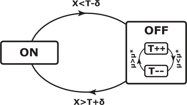

The FSM is modified as presented on Figure 2. During the off state, the growth rate of the biomass is checked. If it is above a growth-threshold µ* (biomass growing), the value of Tn is increased by an amount γ∆t. On the other hand, if it is below the growth-threshold (biomass at rest) then the value of Tn is decreased by the same amount. The procedure should only be applied during off states because it is difficult to assert the growth rate of a volume changing culture with cheap DIY sensors.
In the description, I have considered the growth rate which can be approximated during an off state as being related to the ratio of the current and previous biomass concentration:
However, as for the biomass sensor, we do not need the actual growth rate of the culture since all we need to know is if the biomass is at rest or not. For that purpose, we may simply use the derivative of the biomass sensor:

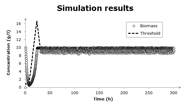

Finally, the model was tested on a simulated Saccharomyces cerevisiae fermentation reaction (Sonnleitner/Käppelli model) with an initial biomass inside a 1 litre reactor of 10 g/l with 20 g/l substrate initially present. The maximum feed rate is fixed to 1 l/h, δ to 0.25 g/l, µ* to 0.05 h-1 (growth rate version) and γ to 1 g/l. The initial threshold T0 was fixed well above the optimal value (calculated to be about 10 g/l) to 1 g/l. The simulation was run for a 300 hours scenario and the results are presented on Figure 3 with ∆t steps of 10 minutes.
The FSM first obey the dilution rule because the initial biomass amount is above the threshold T0. Once the system reaches 1 g/l (T0), it starts increasing slowly the threshold as long as the culture grows. It reaches the optimum value after about 20 hours where it settles for a few hours due to an overshoot in the threshold value (up to 17 g/l which is not possible for the culture given the operating conditions). The model behaves relatively good in terms of identifying the optimal threshold and operates quite well after that. The initial overshoot can be dramatically reduced by using a better approximation for the initial threshold value.
Concerning the productivity, it reached 60% of the best theoretical value for chemostat models but it was found to be highly dependent on the value of ∆t. Using smaller steps, such as 1 minute, allowed increasing the productivity above 85% of the theoretical value. Clearly, some good value can be taken out of this extremely simple model without making lots of assumption about the culture itself.
